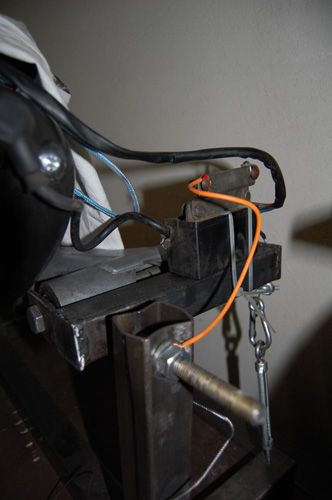

The engine is on a test like I did?:
http://vimeo.com/20407667
In this case, if you connected all like the DS'diagram that I send you long ago you should connect a iron cable or electrical cable that goes from the black BOBINA FEMSATRONIC to the engine to do "massa"!
In this way, is the orange cable in the photo....or you have to fix directli the black BOBINA FEMSATRONIC on the carters in some way...
85,35 KB
I ope you will obtain spark in this way, if dasen't work better you check better all the connections and put phots of the connections hier and show it...
In this way, is te orange cable in the photo....or you have to fix directli the black BOBINA FEMSATRONIC on the carters in some way...
85,35 KB

HI yes I do remember you now...hello again..thank you for the reply it has been very helpfull. I was not putting a wire from the FEMSATRONIC box to engine, so will try this and let you know how I get on ok. Thanks again darren. I live in WALES I think I am the only person with ds HAHA one year I hope to do some europe rallys, so might see my scooter. Ciao take care
